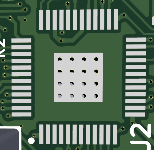

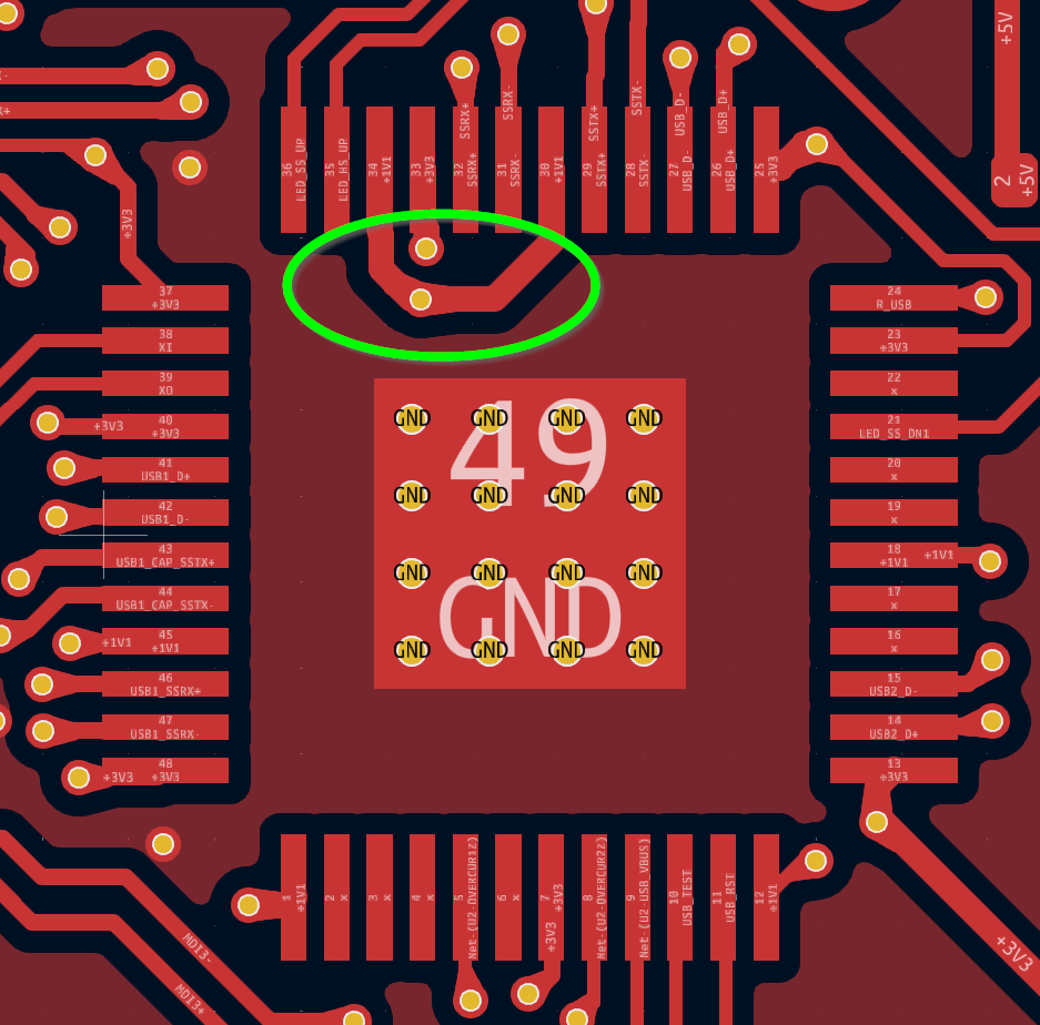

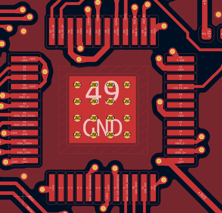

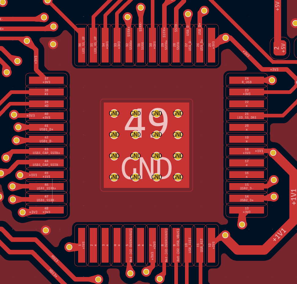

FuzzyOtter tbh I didnt see that picture all those months now in the datasheet until you mentioned it. I was always going until page 37/38 where I thought the datasheet ended. I was wrong 🙁
Definitely the vias are not tented.

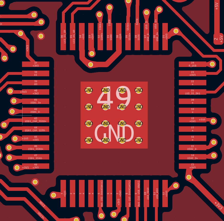

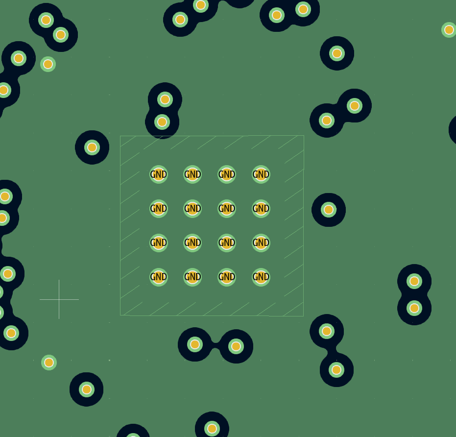

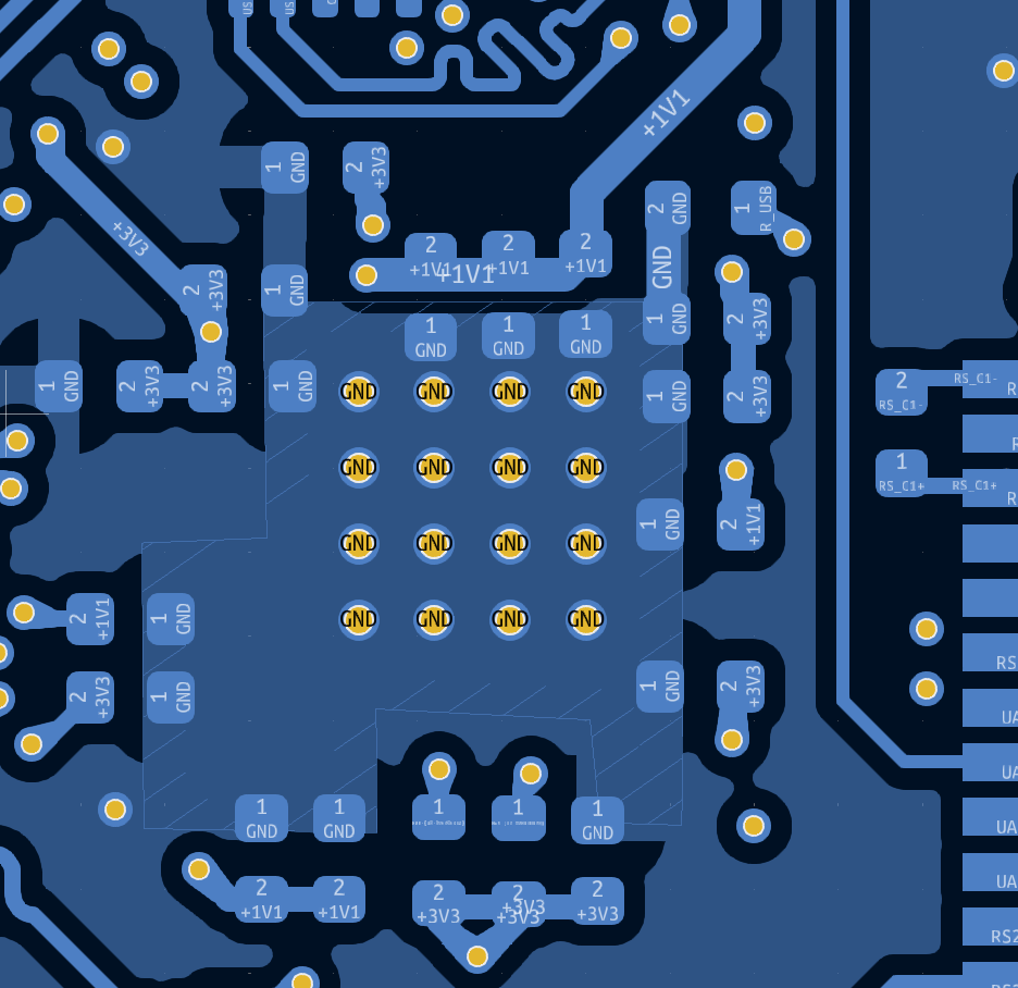

On my new design (attached) I placed more vias and now I think I would place even more. Not sure if there is a way to remove vias and make it a solid piece through all layers as copper or something like that. Need to check.
I dont believe there is a short somewhere since I had 4x PCB made and all of those have the same issue.

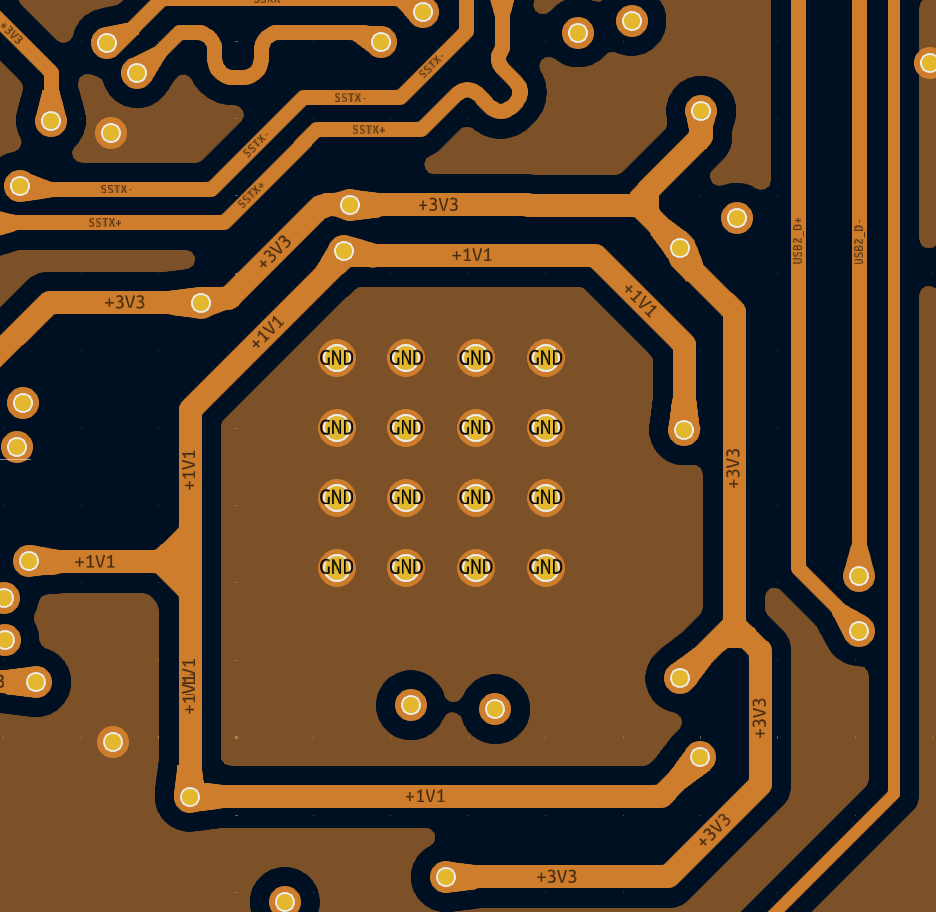

The weird thing is that yes it does have more vias for the IC but I see them only around the pad not in the center.

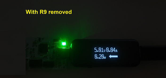

elessargr , 09-11-2025, 07:55 PM
So this is with R9 removed.
The PCB I dont think its get any increase in temprature. Maybe few degrees since I can see the IC showing up but nothing as before.
Also when I connect it to the PC its not recognized. So I think the IC indeed is fully off.
Ignore the IC on the back.
QDrives , 09-11-2025, 08:32 PM
No, with R9 removed, the IC should still be powered. It is just in the "Disconnect from host" mode drawing little current.
The PC should not recognize it, as the IC thinks it is not connected.
If it does not get hot this way, we can mostly rule out any shorts below the IC between 1.1V and 3.3V to Gnd.
Then you have to check all other connections and modes.
One last 'failure' could be that the thermal pad has not been soldered properly to the board.
Then you need to check the temperature on the back of the board during power-up.

Well I know that on the current prototype version of my PCB I dont have enough VIAs. I placed only 4. The back of the PCB is getting hot definitely. I have couple thermal videos that shows this. Front side on the IC I see 55-62C and on the back is 53-56C

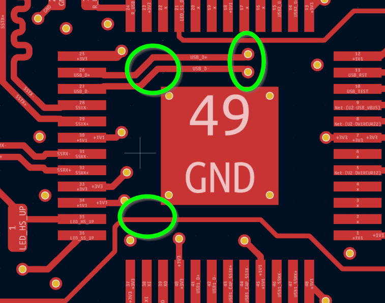

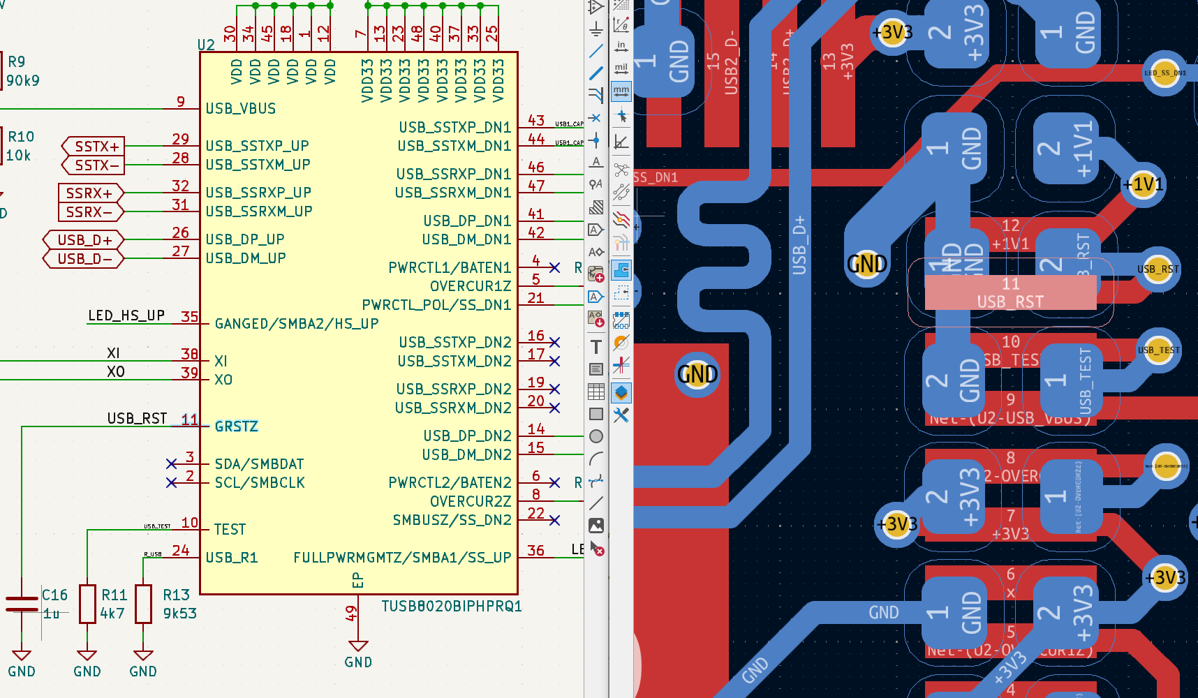

I would verify pin assignments first, both in schematic and layout.
Not only of the hub, but also of the things connected to it (like connector and mux).
Also check that there is no short to the connections encircled to Gnd.
