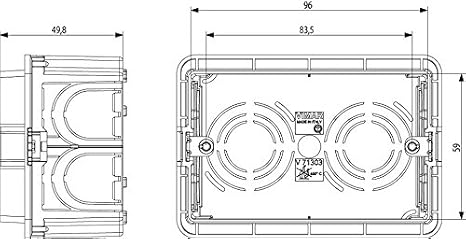

Ths SBC should be the Main Board of my FCThermostat project an IOt enabled Smart thermostat. It should combine a thermostat and a smart speaker inside a small package that can be embedded in a wall. (The dimensions of the wall box it should contain the device:
https://images-na.ssl-images-amazon....tL._SX466_.jpg)
